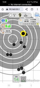

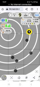

500 yard pressure test. 26 inch barrel, H4350, 210M, RP brass, 140 hybrids @ 0.015 off.
The last 2 loads clustered nicely
Handed the remaining loads to a friend to fire off. Last charges clustered as well.
