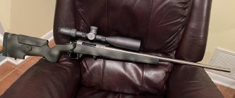

Got the .260 AI out today to start forming some brass and I have to say I’m amazed at the results. Just got the barreled action back from Lee Gardner and I have to tell you, if you need something chambered Lee is “the man!”
My intent was to form some brass to get a die on order, but dang, it shoots out of the gate! I threw 41 gr of IMR4350 under 142 SMKs right at the lands and off I went. After barrel break-in and scope adjustment shot these with the last 10 rounds. Low shot was foul shot after last barrel cleaning.
