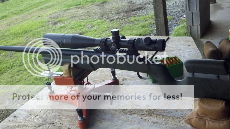

I have both, and they will hammer!!!!! but I would go with the 260 Rem just because of brass. I just bought a butt load of 7mm-08 and re-sized it and it works great!
Plus I`m putting together a 260 Rem "hunting rifle" because the 260 I have is little heavy to carry in the woods...
and the Creedmoor aint light either..
but they`ll shoot! either way you go a 6.5 round is hard to beat!
