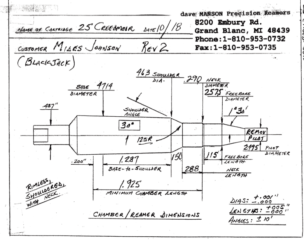

25 Creed: We have seen rifles as short as 22" running 2925 fps up to 3070 fps in 26" barrels. These reamer prints will cover all the known brass types on the market. The Revision #2 of the 25 Creedmoor Blackjack print added 0.001" to the neck diameter to further accommodate an old run of brass which is no longer made to that spec, but there are still some samples floating around. These specs will work in 2.880" magazines but will also be at home in extended mags as well.
JGS 25 Creedmoor BJ - the 2nd batch of 25 Creed from JGS arrives in January
released-jgs-25-creed-blackjack-spec-rev-2-0-290-neck-png.110968
Manson 25 Creedmoor Blackjack - the 2nd batch of 25 Creedmoor Manson reamers arrives in December
25-creedmoor-blackjack-rev-2-manson-png.110969

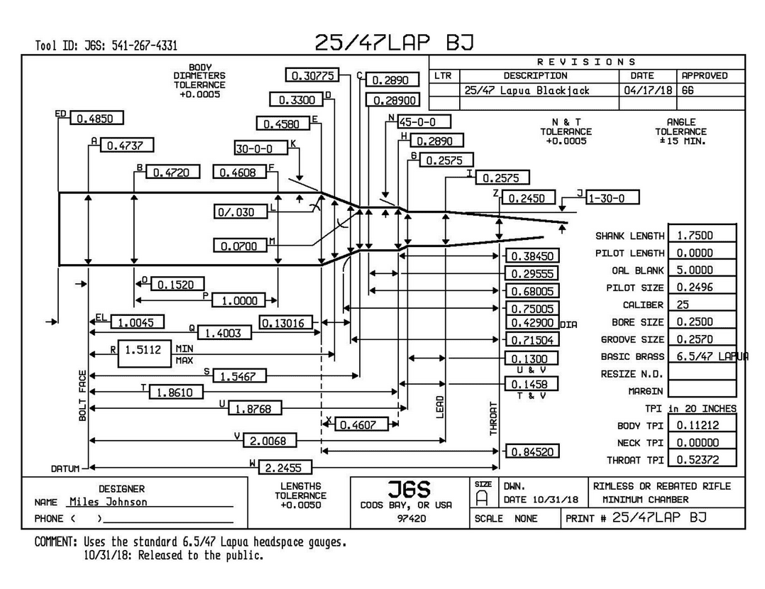

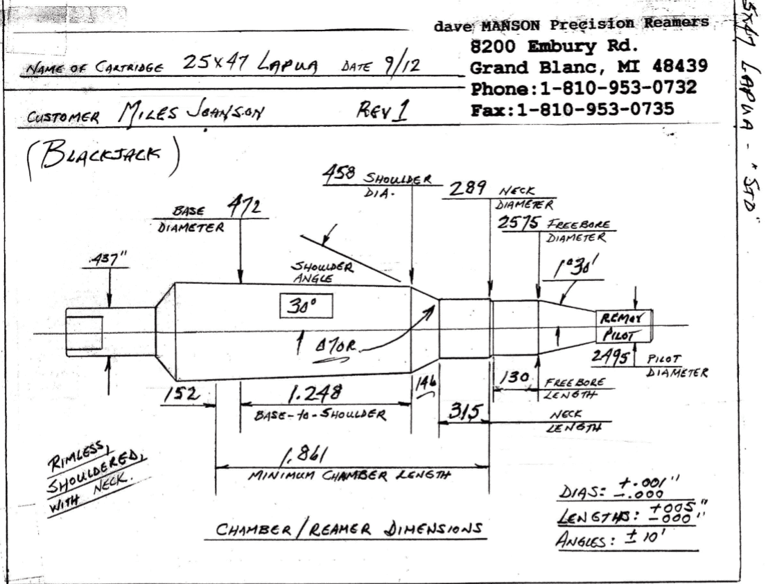

25x47L:
As easy as it gets. Most of the 25x47s chambered have had no issue at all running 2970 fps and that coincides with where this bullet wants to run at different speeds in 25x47, 25 Creed, and 25x284 in slow nodes in the latter two chamberings. Since there is only one supplier of brass there is no need to worry about reamer compatibility. This thing is setup and these rifles are shooting very well. We have been sent multiple < 0.25-0.33 MOA 8-10 shot groups at 200-300 yards and very impressive groupings at 1000 yards as well. The very first matches where 25x47L showed up running 131 ACE bullets, the contestants got 4th and 2nd place amidst tough PRS/Tactical match competitors. We have a good bonus program for guys in Winner's Circles or PRS, NRL, and F-Class competitions.
JGS 25x47L Blackjack Spec - the second batch of JGS 25x47 will arrive in January
released-jgs-25x47l-blackjack-spec-png.110970
Manson 25x47L Blackjack Spec - the second batch of reamers will arrive in December
25x47-lapua-blackjack-manson-png.110971

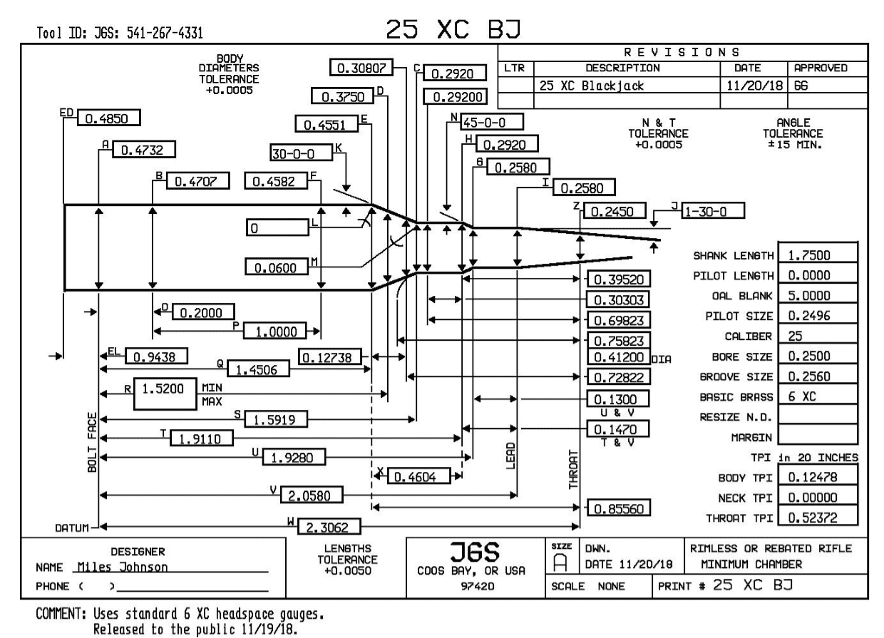

25 XC:
Like the 25 PRC, 25 SAUM, and others, we produced this reamer spec due to 25XC demand from shooters we know and have been messaged on facebook. This cartridge should run 2970-3050 fps in decent length barrels and with the assortment of XC brass these days a guy should have no trouble getting components. If a guy has been an XC shooter for years he won't need to go buy any 47 or Creedmoor brass to get going in high performance 25 Cal quickly.
JGS 25XC Blackjack Spec - these reamers will be in stock in January when delivered.
25-xc-bj-jgs-png.110972

Why such a large neck diameter?
My best guess is that they are large to work as a no turn with plenty of neck clearance. My 25X47L is a .283 neck which leaves the brass at .012" neck thickness after turning.
The 25 Norma Dasher has a .284 neck
These reamers are designed for the Field Style shooters from Tactical Matches to PRS to state level prone style matches. We know some guys will want to order "tight-neck" style reamers but we would definitely have more headache if the reamers we stock and spec out had any chance of having clearance issues. For the custom guys it's best for them to order to their preference. That being said, these reamer specs are shooting great at 600,800. 1000+ yds.
Please let me know if you plan to order a tight-neck version and I will add the print # to my database for when people ask for that type of reamer.
