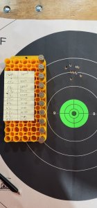

Im running h1000 in my 22" 25 saum with 133's at 3025 fps. Single digit ES and sub inch vertical at 625 yds. .1s at 100. I had a upper node at 3100 but it wasn't as wide or consistent as the 3025 fps node.
UPDATE:
I backed it down a 1.2 gr to the next lower node and now I can run it 50 rounds between cleanings without it pressuring up. I run suppressed so alot of times that will require mild loads if you don't want to be forced to clean every 25 rounds.
Off a bipod and NF 4-20 ATACR its averaged .3 moa vertical at 625 yds for the two 6 shot groups Ive done so far to verify it. The 3 shot group at 625 measured 1.4" with .7" vertical. .1" at 100. ES is great. 133@2990 fps in a 22" barrel. Yes I could get more speed with Reloader 26 or n570 but in my experience theyre very dirty when running suppressed and require cleaning every 25 rounds before they velocity migrate or pressure up. For a compact suppressed deer/antelope setup it doesn't get any better than this in my opinion. Ill be limiting my shots on game to 800 and in. Reticle doesn't really leave the 625 yd target during recoil.
