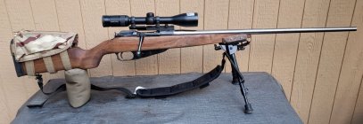

I built another 25 Krag Ackey.
The first one was on a Krag.
The second on was on a Mosin.
