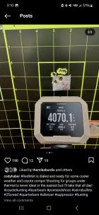

Morning everyone, I will be playing with a new build that I happened to think about. There is a guy i know running a 10 twist 25 creed shooting 70gr Blitzking at 4050fps as a night time varmint rig. It got the ideas running and I decided to run a 25 GT 1:10 24" #5 contour remage barrel. Running the same 70gr Blitzking, its about the same cost as a 6mm 70gr blitzking. Hoping to get 3600-3850 fps when it's all said and done. Will try vsrhet first and see but might need rl15.5. Looks like I should still be able to run up to a 110gr eldx or others. Going for efficient speed with this one just to be different.

Makes me wonder what pixie dust gets over 4,000fps from a 25CM.
Wow!!!

So if a 257 Weatherby shooting 70gr bullets can only achieve 3868fps w/ 80gr of powder
How’s a 34gr capacity case gonna get 4000 fps w/ 70gr bullets ??
Efficiency???

I suspect the 257 WBY Mag is doing that within the pressure limits of the brass and action.
I also, knowing a bit about how IMR8208XBR can be crazy fast, suspect that 25GT load would test way over pressure. I have seen personally how that powder can ruin brass while seemingly showing zero pressure signs. No ejector marks, no flattened, pierced or blown out primers but the Lapua virgin brass wouldn't hold a primer and measuring the case heads with a blade micrometer showed excessive expansion.
