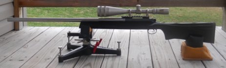

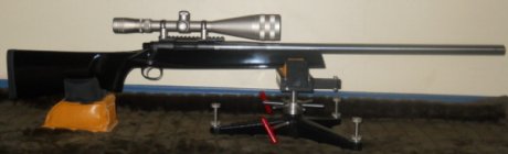

After shooting my 243AI 40x I decided I needed 1 for Varmints but built as a repeater not a single shot 40x
So I built the same basic gun on a 700ADL action with a 4 shot in-box ADL mag.
Trued 700ADL
PacNor 27", 1/8 twist chambered for .270neck 243AI
HS stock cut for a ADL box mag
ERP firring pin assembly
ERP super lug
Jewell 2oz BR trigger with bolt release
Badger 20moa scope rail
Redfield 6-24x56 Mil-Dot scope
