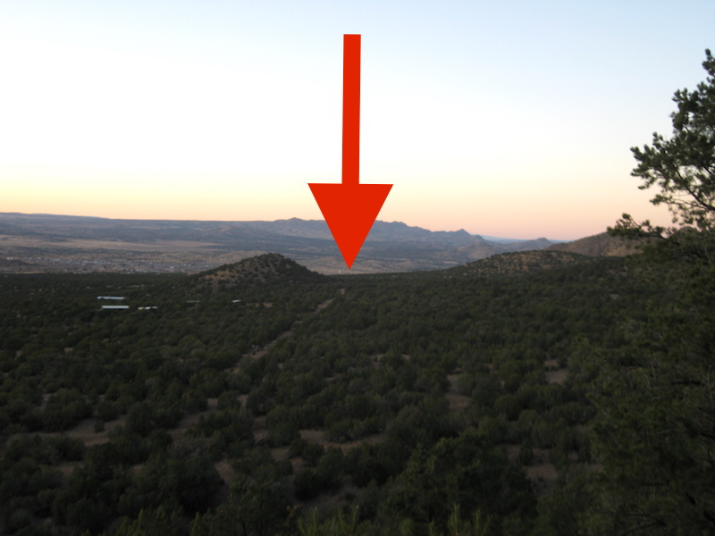

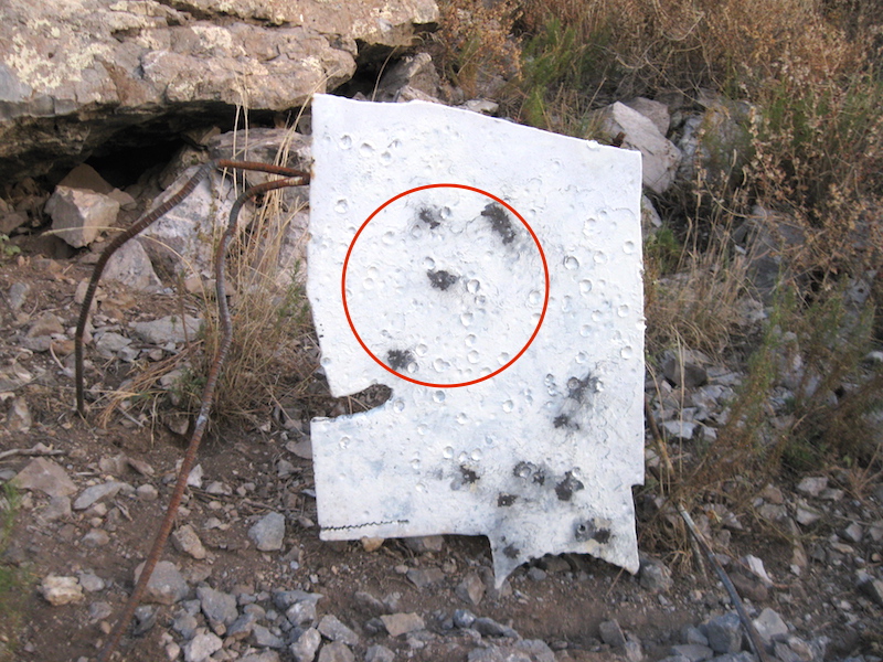

Hey, I tried your suggestion, I tried to shoot my .223 WSSM at 1000 yards, not that it has anything to do with this thread. I had fun anyway. The best I could manage is 965 yards since the Plague has all the ranges closed. Shot prone off bipod and rear bag.
Here's 525 yards (.59MOA) 12" x 12" target:
And here's 965 yards (.77MOA) all 5 in the "ten ring". Target's roughly 15" x 19"
Shooting position:
IMO, that's not bad for SAMMI-spec .22 cal cartridge that was never intended to be shot at ~1000 yards, shot by a rank amateur, using 'cheap' components, who 'smiths his own guns in his garage with cut-rate parts. Imagine what a seasoned benchrest shooter could accomplish with 'premium' componets with a rifle plumbed together by a real actual gunsmith who knows what they're doing! Too bad the WSSMs all suck though, and it's an exercise in futility.
