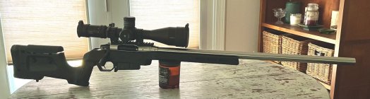

So the barrel was delivered yesterday. It’s the Shilen with a 1:7.5 twist, ratchet rifled 4 groove, 28 inches long. Will be putting it on a Bighorn Origin action and mounting it in a MDT chassis. Picked up some Vihtavuori N160 Powder and have plenty of Sierra 107 gr. MatchKings on hand. Just have to get it put together hopefully over the weekend, mount the optic and see what it will do.

It is all put together and looks sweet, but I have not been able to get out to the range. Got a rather severe cold, and that has limited me. Hopefully that will rectify itself soon but I thought I would share the picture. It had a MDT XRS stock and a Arken 5–25 EP-5 optic.View attachment 1421841
Nice looking rig. That Twist will handle the 115 gr. Bergers with no issues if you get around to trying them. This is typical of my 243AI with H-4831.
