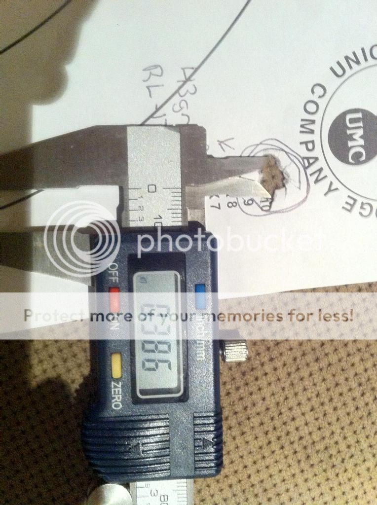

I would like to use it for long range target then coyote hunting as well. But getting my hands on the Berger's like i said aren't always easy and generally a little more expensive. Especially when im not sure they will even stabilize in my barrel. I am hoping to grab just a couple off a buddy to give a go. I found some RL-17 sitting at my place that was going to be used for a 300. wsm and read it worked pretty good in some short calibers. played around in the basement last night and had some pretty good luck today at the range with RL-17. Started at 42grs and worked up too 44grs and and 43gr looked like the perfect starting point to see if i can shrink it again. I dont have a chrony yet to test what i am getting but i am sitting at 2.735" COAL with 43 gr's of RL-17 and getting what looks to be great accuracy!
I am hoping to get a chrony in the next couple weeks (Christmas season, just have to watch spending limit) to test the velocity and probably going to pick up some H4350 as well since there is only 1LBS left at work and see if i can get my hands on the 105's or 95's. seeing the accuracy of the 87 is got me thinking it wont stabilize the 105's at all.
Well i will be heading out tomorrow to spend a little time with my first load work up for some 105 gr bergers and see if she will stabilize at all! and if so i will begin to back it up a little! i also loaded up some more 87gr vmax to see if it was all luck or if it happens to be a half decent load! keep you updated on those 105's
