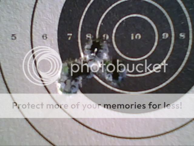

You may want to look at Retumbo, too. I use it in my AR10T 24" and get better velocities than H1000, and comparable accuracy. 3K fps vs. 2800 did it for me. Sorry for the crummy cell phone pic, but that is 5 rounds into a smallbore target at 100 off a bipod.
Found a better picture and more info.
