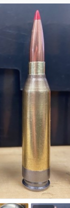

I started by resizing the 6.8x51 Sig hybrid case to 243, turned the necks from .017" to .012", worked up a load using RL17 and the old 105gr AMAX, and settled on 45gr of RL17 for a 5 shot average of 3,373fps with an SD of 5.4, 3,367fps low and 3,381fps hi. Indications were I could easily go into the 3,400+fps range, but 3,373fps with the 105gr is well above a 240Bee and my 6-06. After fire-forming, the first 5 shot group came in very good with the first shot from a clean bore slightly lower than the next 4, which those 4 came in around 0.2".
After a little more longer range testing, I plan on using this load for LR hunting, but I also plan to load and test a few 105 Berger VLD-H's with hopes they will do as well or maybe even better.
I just wanted to state that other than experimenting with the hybrid case for higher velocities, I was desiring to create a 243 load that would somewhat substitute for my 6Rem and 6RemAI loads. Those brass have become difficult to find, and I have become rather sparing in their usage.
Since this venture has shown such good promise in velocity and accuracy for a lower volume LR hunting and target load and I have obtained a good stock of cases, it appears this will keep my other larger 6mm's at home for a while.

Have you full length sized the cases yet?
Just wondering how you plan on sizing the steel base.
I have been using this brass in a .243 Win. AR10 with a 20” 1/7 twist X-Caliber Barrel.
Load Data so far with no signs of PSI….106 A-Tip, CCI#34’s with 38.2 Grains SW Precision seated about 0.150” off the lands. Shotmarker indicates it’s still running just under 1900 fps at 600 and over 1400 fps at 1000 yards.
For brass prep….all I am doing is running well Lubed New 6.8x51 SIG Brass through a .243 Win. FL Sizing Die. I am using a 0.008” Reading Competition Shell Holder, bumping the shoulder back around 0.047”-0.050” (Headspace is set to 0.003-0.005”).
I have reloaded/fired some of these as many as three times full length resizing each time with no issues….. They haven’t needed trimming until the third firing and probably could’ve got away with not doing it then…… just wanted to cut them back so all would be the same length.
