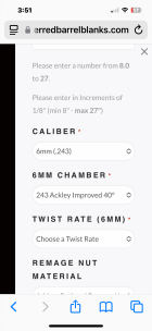

Will these dies match what the barrel manufacture will chamber? If I get a reamer print from them do I need the shoulder area to be .460 or .455?

Does anyone know if Redding will tell me the size of the shoulder/ body junction on this sizing die or is it a mute point since it’s a neck sizing die?
