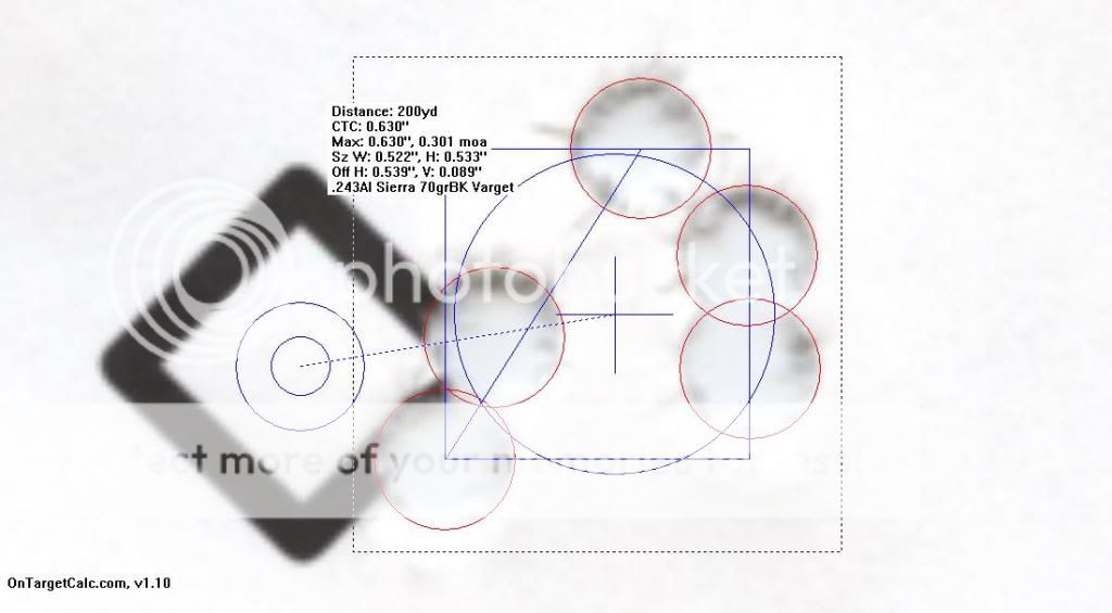

Hammond reworked 700 action with 14tw .243AI tube, Lapua cases, Varget, BR2's, Sierra 70 grain BK's=.3 MOA. I tried H4350 and Reloader 17 with .5MOA results but Varget remains the accuracy leader in my rifle. I haven't chrono'ed this particular load but I use 3800 fps in my "Shooter" ballistic S/W for drops to 600 yards.
