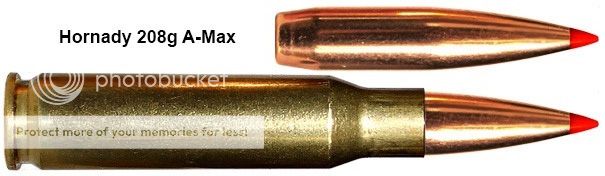

How fast are you pushing the 200.20X's? I don't shoot competition but a bullet that had worked for me for out to 500 yards is the Hornady 208g A'Max or ELD Match. I've never worked up a load for accuracy with these but loaded them reasonably hot for distance. They have shot to 1/2 MOA at 500 yards. The bullet is long which will restrict the powder load in a standard chamber, with a lot of bearing surface remaining behind the neck when loaded to 2.972" (pictured below) giving me .025" jump.
I'm running the 200.20Xs at ~2660 fps with H4895 out of a 30" barrel. There are a couple major differences between the 200.20X and the Hornady offerings you mentioned. First, they are secant ogive bullets, which may mean their seating depth preferences could differ from that of the 200.20X or 200 Hybrid, which have Hybrid ogives. Second, the Hornady bullets have longer bearing surfaces as compared to the 200.20X, which may affect velocity and will usually mean that you have more shank in the neck and/or down in the case at a given seating depth. Neither of those differences are deal-breakers in any way, just differences.

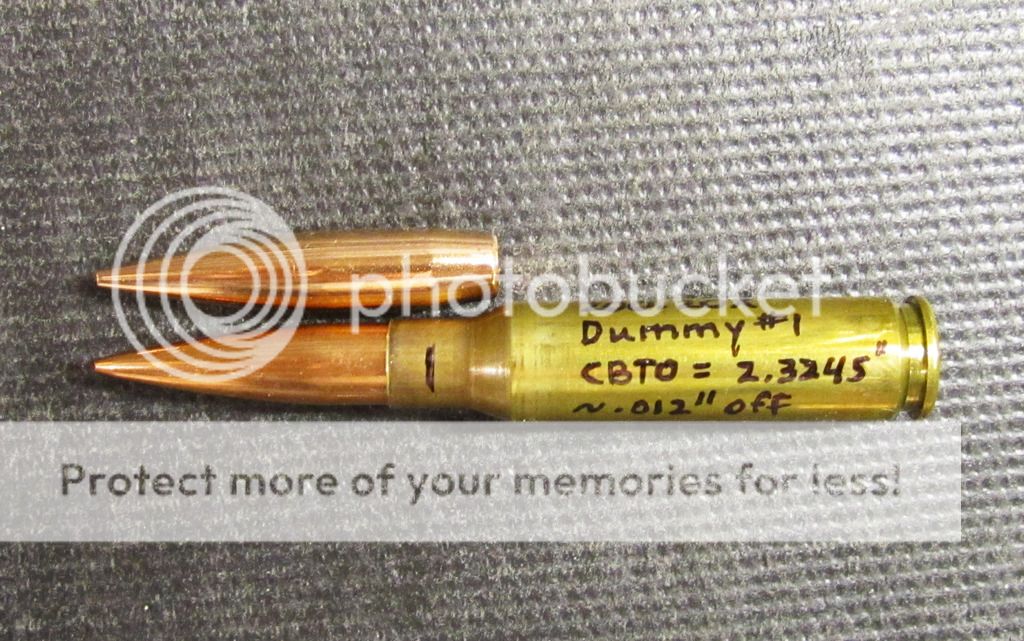

In the image you posted, the boattail/bearing surface junction of the bullet [as seated] is below the case shoulder. That means you are giving up considerable effective case volume to the boattail/shank of the bullet, producing higher pressure at a given velocity, or limiting the velocity you can reasonably attain at a given pressure. My 200.20X load in the .180" freebore chamber has a COAL of 3.114", which puts the boattail/bearing surface junction slightly below halfway out the neck (see image below). If you were to seat the 208s any deeper in the case, you might even reach a point where the pressure ring of the bullet bearing surface is below the lowest point sized on the neck by a standard bushing die. In fact, you may be there already. That may work ok, but is not optimal. I'm guessing you'd be getting somewhere in the neighborhood 2475-2550 fps with the 208 loaded in that manner. Again, it may work ok, but it's not what you could be getting with a more optimal freebore that allowed to seat them out substantially farther.
I canceled the Sierra order and ordered a box of the 200.20x. I don't have the freebore to seat them out as far as you do here and I seated them at .025" off the lands where everything else seems to shoot well. With the short bearing surface I still have about 80% contact in the neck. I also remeasured the Hornady ELD in the chamber. I think the other picture I posted was wrong as it looked like the bullet was seated too deep. I have no idea, that was a couple years ago. I'm going to start with the load I used with the ELD and work up in 2/10 increments. Hope to see above 2,500 fps, the ELD is maxed out at 2,430 with a slightly compressed load of Varget. If anyone had too much freebore and need to seat out farther, the Hornady would work and keep more contact in the neck. I noticed that when using the Hornady comparator, these seat .010" farther out than the ELD's to keep the same jump distance. That tool measures .298" inside. Also these Berger bullets are more touchy to measure in the chamber. The slightest bump or pressure will push them .010"-.015" or more into the rifling and give a false reading. I used 3 different bullets to be sure I was getting the right measurement and not altering the surface.
It looks like the 200.20X is seated more optimally in the neck compared to Hornady bullet with its longer bearing surface. The longer and "pointier" the bullet ogive, the more sensitive it will be to accidentally being pushed into the lands when using the Hornady OAL gauge. A little practice with the tool is usually sufficient to develop a good feel for the difference between just barely touching, or .010" into the lands. As you noted, it's alway a good idea to check for land engravement as well. I typically select 10 bullets at random from a new Lot, number them with a Sharpie, and use them as a measurement "set" to periodically measure the distance to the lands as long as I'm shooting that specific Lot of bullets. I use the average of 10 measurements as the baseline for seating depth. It's not perfect, being a "relative" measurement, but I rarely observe variance greater than about 1.0 to 1.5 thousandths over the 10 measurements. Because I rarely, if ever, start seating depth tests with the bullet closer than about 3 thousandths from "touching", it works well enough to establish a baseline reference measurement. In any event, let us know how the 200.20Xs work out for you. Good luck!
