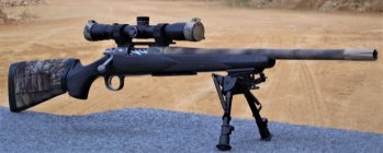

22X47 Lapua
Very nice setup. What do you expect for bbl life alf ? The longer neck could/should/might let it live longer vs a 22/250?
Thanks.....
I don't expect to ever wear it out. Since load work is done, I won't shoot it anymore other than to check zero or smoke coyotes. I have others to use for play time.
Yup,.. I too, LIKE the LONGER Neck ! I am hoping that, Peterson or Alpha will make LRP Brass, in .22x47 Lap. AKA,.. Lapua Mini Lazer ! We will go 26", 1-9 twist, short throat, no turn Neck, on my son's M700 SA, to shoot the, 65 SGK's for Coydogs, 70-73 Berg VLD's or, 75 Horn BTHP ( which ever performs, best) for Steel / Targets to 500-700 yds at, a little less Velocity ( 50-100 FPS less than, Max. ) coupled with the NICE longer Neck, to make his Barrel, LAST, a bit longer,.. hopefully! We were gonna go .22-250 AI. The .22x47 L,.."LOOKS",.. better !

Time for an update to this thread & chambering.
I got into night time coyote hunting with thermals, and decided that fast & flat is where it's at for those endeavors, & I finally discovered the need for suppressors as well.
The original barrel on this gun I thought was too small to cut & thread for a suppressor, & I also wanted to go to lighter bullets for for the speed, so I sold the 8" twist, and bought a #5 Brux in 12" twist. I then sent my reamer in to be reground to zero freebore for the lightweights. Once everything was in hand, I had it chambered, & cut, threaded, & crowned at 18".
Bullet of choice was to be the Berger 52 grain Match. I started with them in the lands with CFE-223 that I thought would be a good match. Got them up to 3660, but not the accuracy I was looking for.
Next up was Varget. Better, with groups 1/2 to 3/4 MOA at 200, 3754 highest velocity.
H-4350 next, got up to 3620, best group was a .370" at 200, but only 3306 fps. I didn't shoot it again to see if it repeated.
H-4895 was the winner. Two back to back 5 shot groups at 200 were 1.4" & 1.5" at 3730.
Problem was, that jug of powder was almost empty, and when I drug out a new one, it was a different lot....great. Testing at the same charge, it shot just as good with another 50 fps or so velocity.
I had a brief fling with 40 Ballistic Tips getting them to 4100, but didn't pursue them seriously.
I haven't shot anything with this yet, but it's ready to go.
My AR's seem to get all the action now, which I think are better suited for the night hunts, due to faster follow up shots & when calling in multiples.
