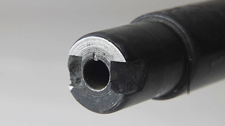

I have a CZ457MTR in 22lr with approx 500 rounds through it. While chambering a round has always been tight suddenly I could not chamber one, so I checked it out with the bore scope. Between the chamber and the extractor grooves, the wall is VERY thin and at the entrance the extractors apparently forced a small dimple into the chamber. These dimples snag the bullet as evidenced by clear marks on the bullet. Also the notch to chamber junction wall has a small chip at the entrance. Due to the tight fit I think lead bullet scrapings got into the notch, which forced the extractors to push into the chamber wall resulting in the damage.
First, does this sound reasonable. Second, can this simply be repaired by chasing with a reamer. Third, is such a thin wall between the extractor notch and the chamber normal?

Cleaning was the first step but not an issue, cannot even get the bullet into the mouth of the chamber. The scrapes on the lead bullet at 3 and 9 o'clock where the extractor grooves are located reflect the problem. I'm surprised how thin the extractor groove chamber wall is.

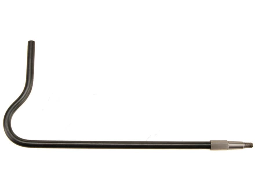

There is a tool available for making this repair, that replaces the out-of-production Menck tool:
