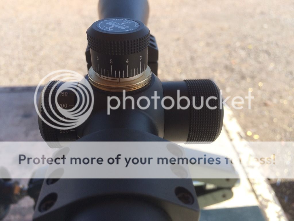

Couldn't tell honestly why. I used a buddy's and mine. I've only shot it from 1-500 yards due to the wind here and everybody getting ready for hints the range is always packed. I have a rcbs. I backed it to 49gr and get 3625 there about
This is where I'm at from a 100 yard zero to 505 yards
Here's my chart

Gotcha.
The ballistic snapshot is showing you need "19.5 clicks" for 500yd dope
But in your pic, there are only 18 "clicks" (4.5 MOA) dialed on your scope?
If you're running that dope from a true 100yd. zero, that correction would imply your muzzle velocity would have to be ~3950fps with a 75Amax ???
Just sayin', something ain't jiving right with the #s. At all...
No matter really, as long as you know what to dial for your own purposes.
Just had a hard time wrapping my head around the outrageous muzzle velocity claim, and wanted to help clarify the #s for everyone else reading along...
Thanks for the pics & info!
Ya. Idk. I know that's what two seperate Cronus have said wishing 50fps of each other. In that chart I have it 3860. Hers my strikes at 505
