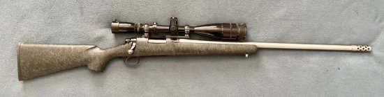

Photos - .223AI - 25" Schneider 14tw / 0 freebore / .250 nk / 6-24x44 Pentax. Working load is that 3825. The 14tw. also shoots 55Blitzkings (which everyone knows are too long for a 14tw) about the same accuracy. ***Ackleys like to be pushed. Groups tighten up as velocity increases, not just with this chambering.
