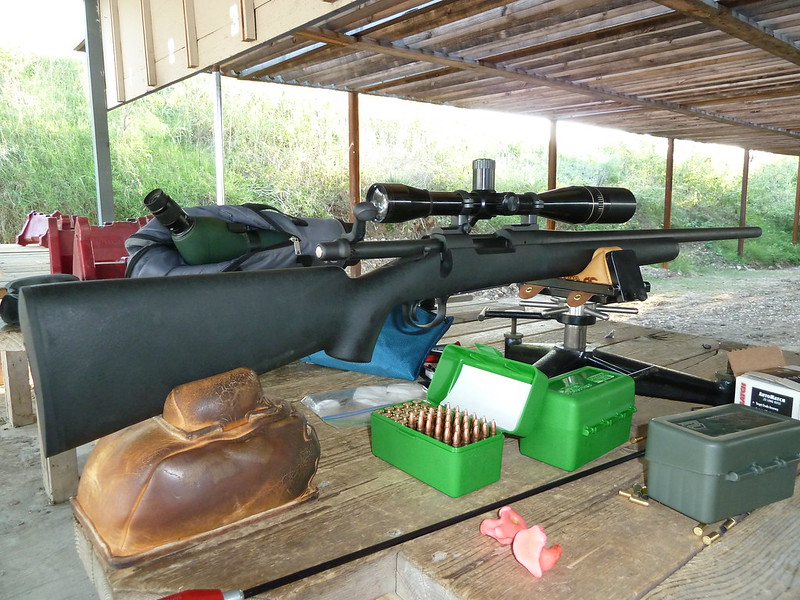

5 shot groups at 100yds
Unless you do your own smith work it is a waste of money to have a 2000 round factory barrel rechambered. Start with new. I love my 223 AI. 50g Vmax and VV133.
considering i got ~7500 out of my last factory 223 barrel......i don't see how it's a waste to get 5000 more out of my current one... $350 is a lot of money for a new barrel when the factory one will shoot consistent 1/2" at 100yds already
