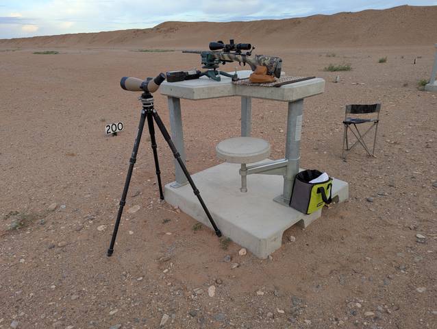

With 50's, VV133 works very well in my rifle..... 14tw, 0 freebore, .250NK. Those. are good powders. These were off the tailgate, parked at 90 deg to the wind and getting full value. It would shake around a bit. That 3825 load is what I use with 50's....nicely effective on critters.IMG_0786 2.jpeg
