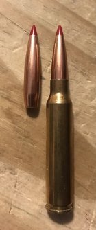

The Wylde is perfect for a bolt gun chamber with 75 ELDs. I have mine loaded .020” off lands at 2.470” oal and they fit perfectly in the MDT mags which can handle up to 2.550”. Below is how they look.
