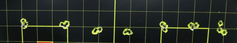

We shot the 75 eldm out to 1000 this past weekend at Bayou Rifles out of an NRA legal AR Tactical Rifle (20" 1/7 .223 WOA Barrel).
They were just barely above supersonic at 1000, but the 16 we fired at 1000 were all picked up by the E-Target (Shotmarker). Vertical was pretty amazing to me (about 10-12")....wind call was pretty tricky, but Logan (13 year old son) did a really good job of keeping them in the 10 Ring.
We are using LC Brass, 8208xbr (23.4), FGMM 205MAR Primers and seating to COAL 2.387" (Same load we use with 77 SMK's loaded at COAL 2.260" mag length). They are launching at around 2840 fps and still going around 1800 at 600 yards.....just barely above Mach 1 at 1000 yards. Note: YMMV..
Looking very forward to shooting more at 600 & 1000 yards.
