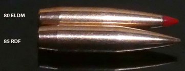

You said in your post before that the bullet was way out of the case @ 2.450. Now you are saying that the bullet is in the case "a calibre deep". If there is that much bullet in the neck and you can find the lands the chamber is fine.
Would you guys check me on something?
In one of the OP's posts he says: "ELD‘s go further in the case than the SMK’s with both having bearing surface in the case".
I took that to mean that there is no bearing surface that's outside of the case neck.
That didn't compute for me. Hence the question about which chamber and then my example of the SMK being able to be loaded long enough so there's lots of bearing surface outside of the case.
Does that compute?
Thanks
He means that the ELDM is longer in the bearing surface than the SMK and when both are loaded to the same base to ogive length, the ELDM will be deeper in the case. If you do not want to encroach on your powder space, the throat needs to be longer to accomodate the longer bullet or you run the risk of the bearing surface being lower than the shoulder/neck junction and donuts starting to form which will effect seating and consistency.

I also took that statement to mean that at the seating depth the OP chose to compare the two bullets, both exhibited bearing surface below the neck/shoulder junction; i.e. "in the case". How that seating depth was chosen (by COAL, having both bullets seated at "touching", etc.) is not clear, but from the way it was worded, my guess would be that the freebore of the rifle may not be sufficiently long to seat either bullet with the boattail/bearing surface junction above the neck/shoulder junction. However, that's only my interpretation.
For the OP, I don't think you're going to find an 80 gr .224" bullet with a shorter base-to-ogive or bearing surface dimension than the 80 SMK. For that reason, pretty much any other 80 gr .224" bullet will likely have more bearing surface below the neck/shoulder at a given seating depth/COAL in your setup than does the 80 SMK. I don't view that as a problem as long as the loads are adjusted accordingly. It might surprise you how much bullet shank is seated below the neck/shoulder in pretty much any commercial .223 Rem load with a bullet of 70-77 gr; it's a lot. You could certainly have the rifle throated longer to accommodate the longer heavier bullets. However, you could also just tune a good load for its current setup and accept that you may encounter pressure/velocity limitations at the high end that you might not with a [shorter] lighter bullet.
To maybe clear think up some what, just touching the lands both have bearing surface outside the case. The ELD sets deeper in the case than the SMK. I think right now I will stick with SMK’s ( still got 400+) and not shoot up the ELD’s and maybe by the time I need more I can find some and I got 500 77’s which could also work. Hope this clears up what I was asking which basically a general consensus of weather ELD’s seam to prefer jam or jump

They like to jump and can jump far and still be very accurate.

With the ELD-M, like the AMAX before it, they don't need to be jammed into the lands in any calibers. I usually start .020" off the lands and rarely move. My 75 ELD-M load is at .020" off in my Wylde chamber and shoots great. You can jump them further also. I have some other ELDs that jump .090 and also very accurate so don't think they need to be jammed into the lands like some other bullets to be accurate.

For my particular rifle, a 1:7 Savage 12 FTR 223 with a 30” barrel, they like to jump .015. My rifle jams at 1.945 CBTO with these and I run them at 1.930. 24.6gr of Tac gets them running just over 3000fps. They are super accurate.

H75Amax - similar profile to 75 ELDM 0.090” off in a Wylde chambered 26” bolt rifle.
