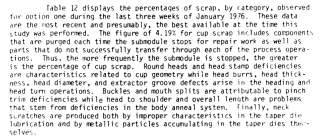

This was a good summary of the stuff that happened long ago, but folks like to reinvent the old problems when they try to skimp on maintenance or push things too far. Nothing new about it, still happens when new folks rotate through the food chain.
Good machinery is one thing, but no matter where we are discussing it is up to the folks that run and maintain the machines and processes that make the difference.
During the cupping operation, if the cups or alloys allow contamination, and the die lubricants and coolants are not very clean, then the problem just carries through the whole process. Starts and stops make things worse too, so general machine maintenance also opens the door for the scrap rate to climb, and escapes then follow.
