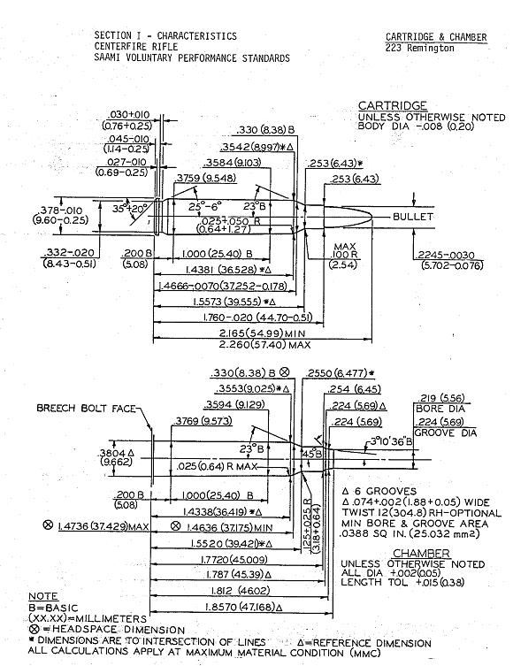

Look at the SAAMI drawing for the .223 below and the manufacturing tolerances for the base of the case and the chamber. I know my Lake City case spring back more after sizing and they have the hardest brass.
And you asked how much smaller a small base die makes the case, and the answer is "it depends". The case diameter can vary .008 and the chamber is .002 now add brass hardness and spring back.

Below the big difference with the Wylde chamber is (G) throat diameter and (N) freebore length. And the chamber base diameter is 0.3810 and all the base chamber (C) measurements are very close. And AR15 rifles are over gassed and forcefully eject cases and make you go look for them.
