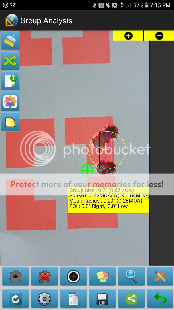

Mossberg MVP Varmint
24" 1:9 Twist 5.56 chamber
80 SMK .020" jump
26.4 grains Shooter's World Match (same as accurate 2520)
Starline brass
CCI 450
3014 fps avg 10 fps std dev.
This is a hot load.
