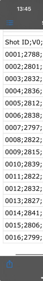

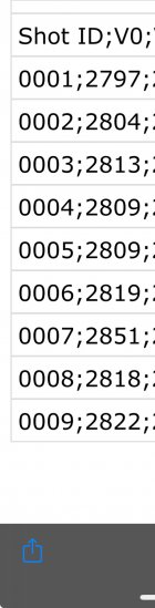

Today I shot a two shot ladder test from my 223 using N140 90gr Berger and CCI-450. These were my charge weights and velocity. I started with a clean barrel and fired five fouling shots.
23.3- 2644,2644
23.6- 2677,2684
23.9- 2708, 2712
24.2- 2738, 2735
24.5- 2774, 2783
24.8- 2788, 2791
25.1- 2849, 2821
25.4- 2838, 2848
Based on these charges and velocities I decided to load 25rds of 24.6gr all the same seating depth. I return and began to fire. Once I was finished. I had velocity ranging from 2788 to 2851.
I was pretty shocked by these results being that the velocity changes were so extreme. Has anyone ever experienced this before? I was not letting my barrel get super hot, it was not a gradual increase in velocity they were pretty sporadic.
I’m not really sure where to go from here.
The grouping at 100 yards is good but I plan to shoot at 1000, so I want to get my velocity under control

Here is what that data looks like. I'm not sure what to do with the screenshot data?
I agree with @Evan that 223 is one of the most difficult cartridges to get a quiet velocity stat I know of.
That said, I don't need to lecture you about how difficult it would be to say anything at all based on these velocity numbers without the target data out at a fair distance to go along with them. You just can't make a decision based on two shot samples of these powder steps.
That chart would say the 25.1 step was bad, but if we had more shots on all of them, it could turn around and be the best for all we know.
I don't want to say ignore the chronograph, but I guess I am saying now that you have seen that data I would ignore it and focus on target data at a distance where the trajectory can tell you the story.
ETA: I don't think an SD of 16.2 is terrible for a starting point. I updated the chart to include the extra shots at 24.6 grains. If you now imagine the same amount of data fro all those other points, you can understand how it is nearly impossible to know anything from a "velocity ladder test" that uses two or three points per step.
That ES of 63 won't cut it at 1000, but would probably clean up with a little more work.
