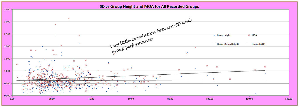

Here is a chart showing Muzzle Velocity SD vs MOA (red plus signs) and Group Height (blue minus signs) for 713 five shot groups which I recorded this Spring and Summer. That's 3565 rounds.
SD vs Performance
Realize that many of these 5 shot groups were associated with load development; therefore, they don't reflect the best possible performance because so much of the tested loads are less than optimum. Nevertheless, the data shows that there is nearly no correlation between SD and performance. The MOA data trend line shows a very slight improvement in group size with smaller SD. But the Group Height trend line is nearly flat.
Can it be that SD has nothing to do with vertical group measurement? I find that hard (nearly impossible) to believe, yet these 3565 rounds show exactly that. You can't see it on this small chart, but one 5 shot group with an SD in excess of 120 had a height of only .085". Go figure.
If I take a look at a better data set comprised of decent shots less than .7MOA and decent SD numbers less than about 40 associated with my ever improving load development, the MOA and Group Height trend lines show that low SDs gives slightly improved performance, but just barely. The trend line isn't quite flat, but darn near. The slope is .003 for those who study such things. That's pretty flat.
I suspect not many people study their SD data this way and just assume low SD's go with good groups. One would certainly think so, but my data doesn't prove it. It just barely even hints at it.
I'd love to see someone else graph a few thousand rounds to see how their MOA vs SD looks.
To answer earlier questions about how far over max recommended charge weight I load, the answer is I don't. In fact my best load for Sierra Match King Moly Coated 69 grain bullets is only 93% of maximum for IMR 8208 XBR. Many of my other best combinations of bullets and powders are significantly less than max.
I measure my charge load on a Gem Pro 250, which I think has a precision advertized to be .002gr. I'd have to dig up the literature to be sure, but it's pretty good. Sometimes I weigh each charge and sometimes I calibrate my Lock N Load PD on my progressive press and let it fill the cases. My typical charge weight extreme spread using the auto powder dispenser is less than +/- 0.1gr with a charge weight SD of around .06 depending on the powder type and shape.
