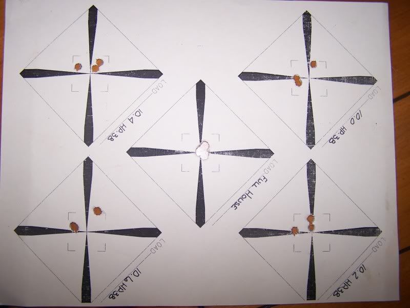

I posted this also over on Savage Shooters and got some great help and reults from a dude that goes by dolomite_supafly, I did some testing Friday and boys all I get is the crack of the bullet breaking the sound barrier and the same POI as my full house 55gr. V-Max loads granted not as accurate but hey they are still under an inch at 100 yards. I eneded up going with HP-38 powder and here's the results, not going to win any BR comps but hey the critters are going to mind. Later,
Kirk
