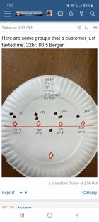

I have shot multiple 5 and 10 shot groups that were sub 1/4 MOA at 500 yards with Brad's barrel with 80.5 Bergers.
Here is a 6.5 CM group shot at 500 yards with one of Brad's barrel.
His barrel work is exceptional.
.07 MOA equals roughly .35 inches.
