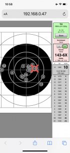

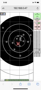

I am playing with a 26” 1:7 Kreiger with a +2 gas system and a H3 buffer in a gas gun pushing ELDM 88’s at 2850. I have not tried to reload any of the brass. Bolt lugs are not showing extra wear. Not a lot of rounds down range (250) but showing some promise.
This is iron sights at 800 and 1000. Held elevation fairly well. 99 -8x in first 10 shots at 800 with that set up. I got behind a switchy wind late in the string.
