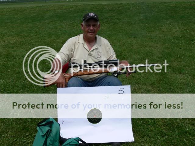

Here is my friend shooting a factory Savage 26" 1/7 twist with 90gr VLD and CCI BR primers and Vt 550 at Connaught ranges last year at 900 Meters 6 1/2 " group
