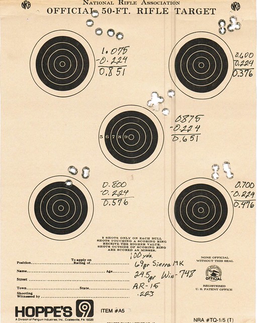

I have used 69r SMK with 25gr of H4895, 25gr of Varget, and 25gr RL-15, 24.5gr of Win-748 with excellent results. Both my AR's will shoot 0.5 MOA or better from the bench with any of the above loads.
The Win-748 load took me from Marksman to Expert in Highpower. Went to 25gr Varget in 2006, then when availability became a problem, learned that the same charge of RL-15 and H4895 work just as well.
Here is my original test target with my AR from 1992.
Here is a target shot with the same load recently.
