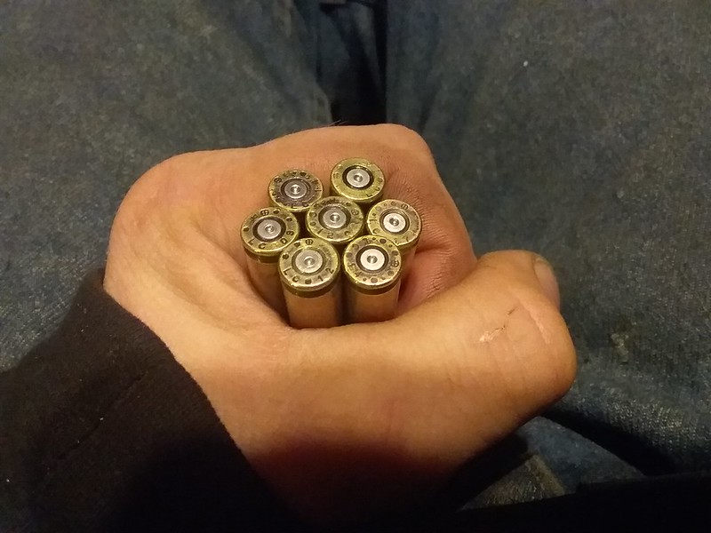

These are some of the cases from a small batch of 26.9gr loads, I market around the primers with sharpie because my recklessness has some bounds as you might say. The light helps accentuate some cratering but that shows on mediums range loads also. I've seen some high pressure cases before and these dont look too bad, not something I would want in a plinking load but for a few TSX loads for science sake...
It must be pretty cold to be shooting 2 grains over my loads.
Just saying bro, if forum boss sees this post...
Just sayin...
You've mentioned HBN, am I correct, you're coating the bullets? That would answer more than a few questions.
