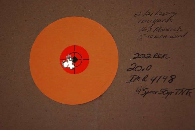

I am long time shooter of several deuces. My present bench gun load is 19.4 gr of IMR 4198.
This can be tuned up in cooler weather to 19.5.
Bullet 52 Sierra match or barts. Both touching the lands.
