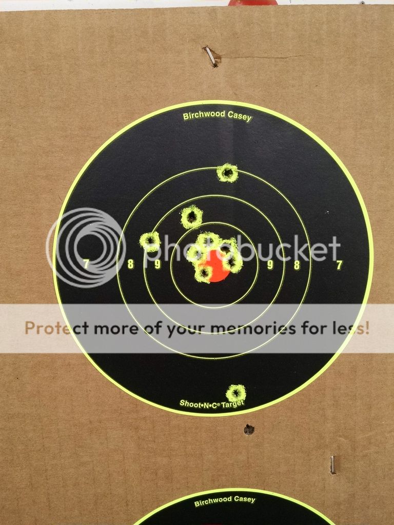

Back from the range..let me say in my defense I had 4 cups of coffee when I gut up this a.m. before I decide to run out to the range.. All my shots were from a gun rest on a bench @100yrds.
I have a Thompson Center Contender with an MGM 14" bull barrel 1in12 twist I recently put a Burris fullfield 6.5-20 ×50 rifle scope on the Contender. It looks funny with such a big scope on it..but man is it nice
I have notice my barrel groups much better after 10 shots with out cleaning.
When its clean it seems to shoot all over, after it gets dirty and warm it settels down nicely. I was shooting 10 shot groups
I had to dial it in a bit and I was using 6" targets.
First 10 shots were 55gr. Sierra spitzer #1345, with a .005 jump
Reloader #7 @ 17.5 gr. , rem 7 1/2 BR primers , lapua brass ,crony reading 2510- 2555 fps.
I cleaned the barrel took some more shots and then shot this .
Again I used the Sierra 55 gr. Spitzer # 1345 , AA 2015 @ 19.2 gr. , rem. 7 1/2 BR. Primer
Crony read 2460-2580
It appears both powders show potential.. Not sure what to try next.
Move up and down with powder charge, or bullet seating
Any comments, pointers welcome
