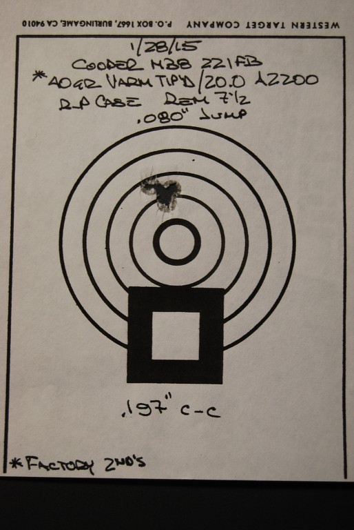

Keep an eye online at the Nosler Shooters Pro Shop, as they run ads for both blems and seconds, but they seldom last long. Make no mistake though, their seconds are only cosmetically challenged, they still shoot!
Both my 221FB's shoot Nosler seconds well (Cooper & CZ), and none of the squirrels or chucks shot with them can tell the difference from Nosler "firsts".
