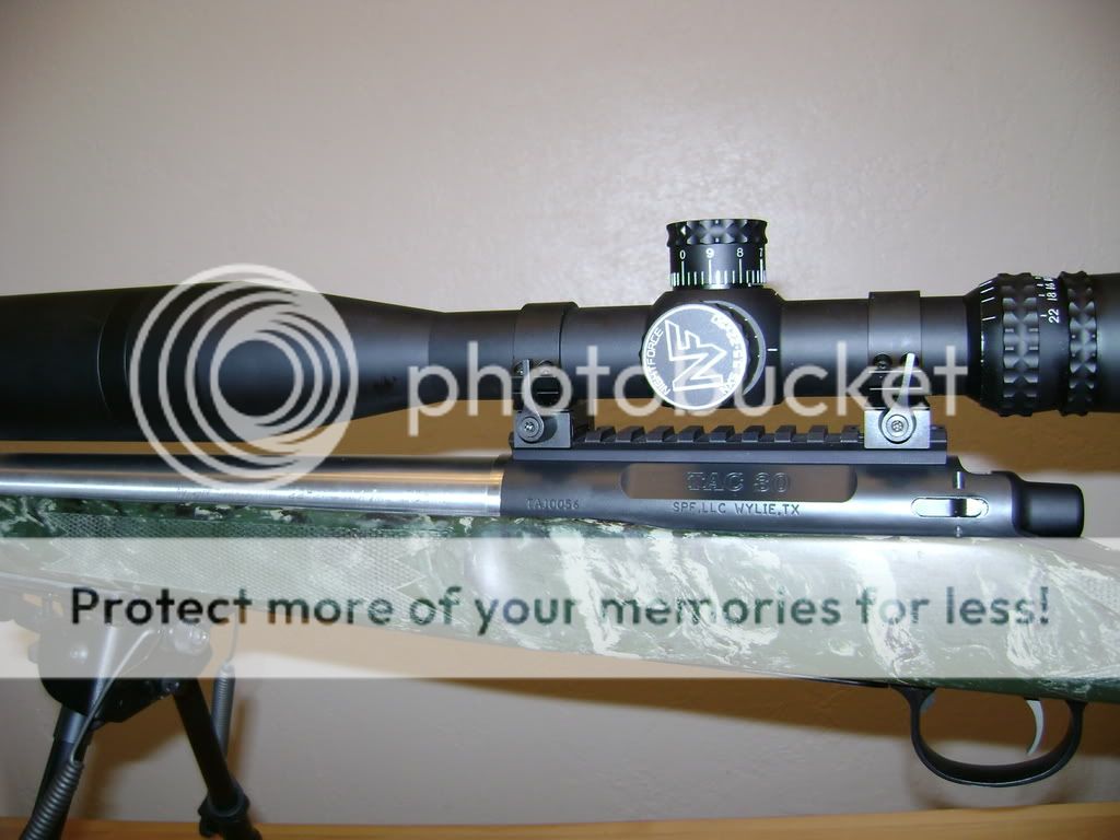

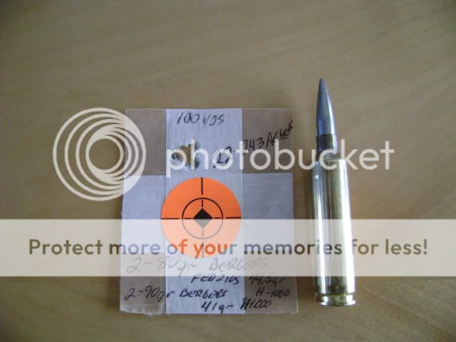

I have a 22-243AI with a 1x8 tw Krieger. It shoots the 75, 80, and 90 grain Bergers very well. It has killed several deer at over 500 yds with the 80's and 90's. Was going to do the 284 case but decided to go this route for a little bit better barrel life.
Nice rifle. What kind of speeds are you finding with the 80's and 90's? How many rounds do you have through it so far?
