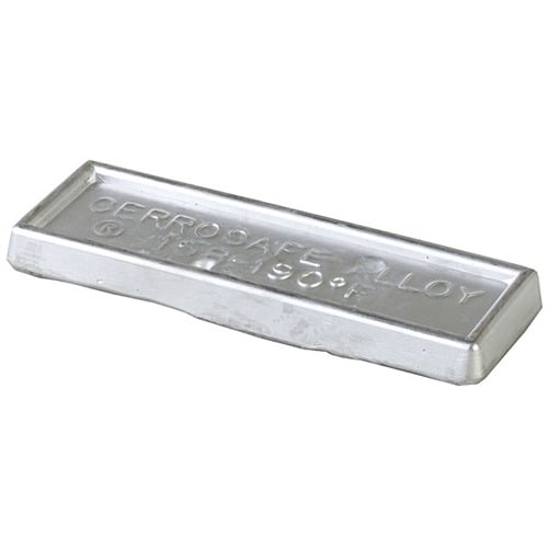

If they dont chamber its most likely 095 short
make a cast of the chamber to know for sure
Then you either have it rechambered to a full length PPC or make some short brass
