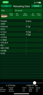

I'm looking for 22 K-Hornet Brass recommendation. I have a Cooper Model 38 rifle and my 1st fireforming load and 2nd timed loaded fireformed load shot fantastic however, the primer pockets are now so loose that some of the primers will fall out of the brass.
Current Brass: Win 22 Hornet in the old Blue Bag
Powder: Little Gun 12.6grn.
Primer: Win Small Rifle
Bullet: Nosler 40grn Tipped (jammed into the rifling)
I did a little research a while back on the Sauber forum and I should have back down the load after fireforming. I'm open to suggestions!!! Anyway, currently my 22 Hornet brass options are the Win in the Re Bag, Nosler and Hornady. What of the three available 22 Hornet brass is the best for fireforming into 22 K-Hornet?

You 12.6 gr should have been fine unless jamming the bullets sent pressures up. My Sierra manual didnt list Lil-Gun for the K-hornet but did in the hornet.

According to Sierra data and QL he was not hot rodding it at all unless he was using a 224 diameter bullet.
a .224 diameter bullet would have put the load at 73,000 psi

Yet the information he provided indicates its safe, so his information is skewed in some way. I suspect a .224 bullet may have been fired in it. His 12.6 gr Lil-gun is perfectly safe in a hornet
Oh yes, the mystery of Lilgun and excessive pressure with “safe loads”. Always good to check more than one source for that powder.

The original question was basically, Im blowing out the primer pockets in three firings using Winchester Blue bag brass. Of the following choices, which brass will hold up better?
Answers
Use brass not listed and not a available
Back off the load.
No doubt PPU brass is tougher, but part of the reason for that is that it’s thicker and has less case capacity.
The powder of choice is known to spike at the top end of loads.
The fire forming load is roughly 15% over the bullet manufactures, Nosler, max load. Add that the bullet is being jammed.
A Quick Look at some issues
Swapping to PPU brass will raise the pressure, hopefully its toughness will compensate for the added pressure.
There is no need to jam the bullet or create a false shoulder to fire form the Hornet brass to K Hornet. It’s a RIMMED case. The brass is held in place by the rim. Load it in the chamber and fire it, a reduced load will help reduce splits, but it really should be in the 1% or less range.
Personally I’d ditch the Lilgun, load some mild loads of 1680 to fire form, then work up a K load using the same powder and never really worry about pressure again.
When you can find some PPU brass, re work the load.
Right now, your problem is more likely powder choice and volume than anything brass related. Other than needlessly jamming the bullet on a rimmed case.

Thank you everyone for the guidance. I do have pound of A1680 powder, 100pcs. of Winchester (Red bag) 22 Hornet brass and a Bench-Source annealer. I also see that the Nosler 22 Hornet brass is available.
I learned valuable a lesson on 1st attempt fireforming 22 K-Hornet brass. The original load shot fantastic while the brass lasted(2 firings). Live and learn...
Additional information:
Years ago, I tried fireforming K-Hornet brass with the #8302 Hornady 35grn Varmint Express factory ammo, in my Cooper 22 K-Hornet rifle. The primers backed out of the factory ammo to the point that the bolt didn't want to open. So, I do believe jamming the bullet into the rifling is a must when fireforming.
