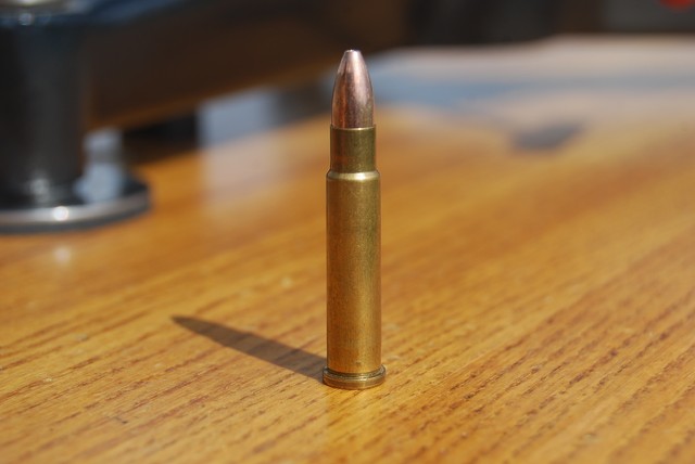

Compare a K-Hornet case alongside a standard Hornet. Any wonder why the K shoots better?

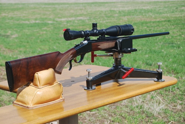

I decided to stay with the original .22 Hornet cartridge.
C.Sharps Arms, 26" full-octagon barrel with 1-16 twist, mid-range tang sight (removed), Lyman STS 15x scope, 50yd zero.
Remington brass, CCI SP primer, Hornady 40gr V-max, 13.0gr Hodgdon Lil'Gun, 3021fps.
