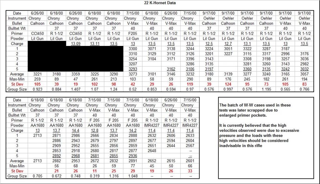

Finally got to chronograph my Hornet Loads :
Winchester Brass
Remington 6 1/2 primer
Nosler 40 grain ballistic tip
13 gr Lil-Guns
Average : 2890 fps
I'm sure some are getting higher velocity but I am very happy with this out of my 21" Contender Carbine.. I've been using this load for years with good success on yotes. I'd be curious to know what you guys are getting.

I'm getting 2970 fps with only 10.3 gr of li-gun behind a 40 vmax. I had to look up my numbers to be sure. it is a 22k hornet however on a martini cadet action. I also tried aa1680 and had good results but slower speeds. next time I go to the range I am going to re chronograph them just to be sure. you have me doubting my notes.

C.Sharps Highwall M1885 w/26" #3 Octagon bbl, .22 Hornet, Rem brass, CCI SPP, Hornady 40gr , Lee FC .002, 13.0 Lil-Gun, 3022fps. I notice the bbl heats up much faster than with IMR4227.
