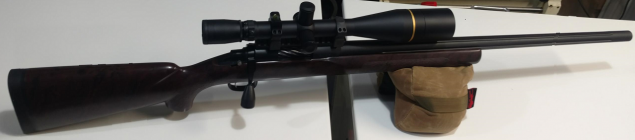

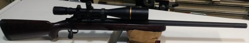

The best I can do on the quality of my pictures of my favorite 22 DASHER rifle.
Pierce Action, Krieger M24 8-twist barrel, Jewel Trigger, solid glass McMillan McWoody Marksman Stock and a Leupold VX-3 6.5-20 x 50 Long Range Scope. She's heavy and well balanced.
Smithed by Pierce Engineering in Lansing Michigan (a Great company with Talented people).
View attachment 1510301View attachment 1510302
Pierce Action, Krieger M24 8-twist barrel, Jewel Trigger, solid glass McMillan McWoody Win. Marksman Stock and a Leupold VX-3 6.5-20 x 50 Long Range Scope. She's heavy and well balanced.
Russell, very nice ! Some first rate components on that long range stick.
Thanks, Paul
