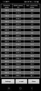

Rem 40x, 8twist kreiger finished at 28 inch.
