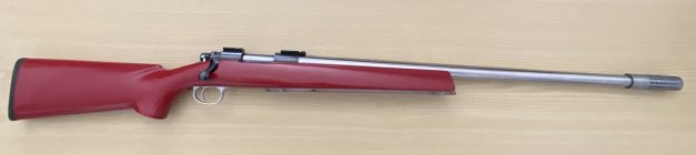

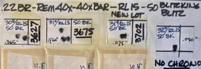

My 22BR was originally a like new 22-250 40X with a 14twist. Thats what it was so that's what I used. Bought and immediately re-chambered to 22BR. This was 1989. In those days the 22BR was made from Rem. 7BR brass.....necking down and then neckturning. Chambers were 22 Rem BR. This one has a .243" nk., very short FB. The builder was an avid benchrest shooter and that was the reamer he used. Only bullets I've ever shot in that gun were the 50 Sierra Blitzking and Blitz. Blitz just so-so, the Blitzking very acurate with Reloder 15. That was the deal back then.. Early 90's I got a chrono .A couple groups in the .0's on the node.. Only .22 Ive ever had that would do that. It won't blow the 22-250AI away, it just won't, , but it's very accurate. Never shot any 55's in that rifle but have had very good results with them in other 14 twist barrels. I don't really care about shooting heavies in a .22.
* Barrel has since been shortened to 24" with a different brake.
