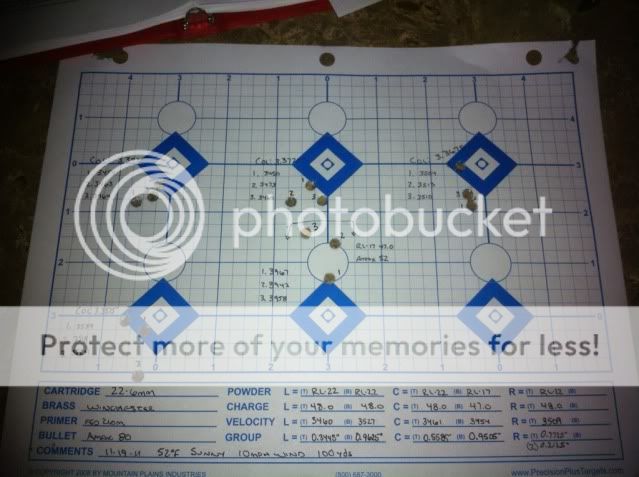

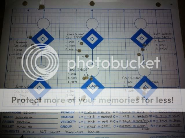

Here's a couple targets from last week. I am trying to understand why the more jump the more or the velocities increase. Any ideas are welcome and encouraged!
