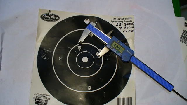

22-250 AI 1/8 Criterion 26" on Savage repeater. Using Lapua brass, H4350 and 75 A Max it will run right at 3450 fps and has shot quite a few 1" 3 shot groups at 500 yds. I don't know how long it'll last but so far so good for me. Majority of fireform loads produced groups in the .25" range at 100yds.

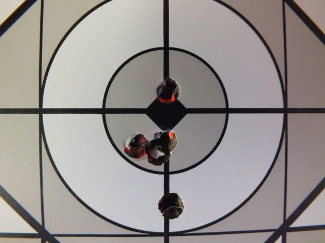

Accuracy is very good using Norma in the 28" barrel and Lapua brass in the 26" with H4831sc and Fed 210GM
The low shot was me 28" Lothar Walther barrel on a Savage LRPV
The center is 5 shots the top and bottom are 1 click up and 1 click down at 100yrds
26" Pacnor SM on a Stiller Preadtor
You won't be sorry RL22 4350 both gave me more velocity but 4831sc just shot a little better
