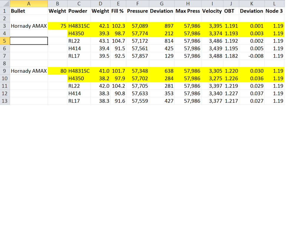

I put together an Excel spreadsheet:
These are still "theoretical" Quickloads Data!
28" Barrel
i have been using h4350 with the 75 a max and getting about 3325fps in a 28 inch barrel
